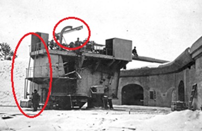

There has been talk on the forum about 302/52 open carriage guns. I am most interested in the 4 "cranes " or "журавль" that were in Ino. I have been there many times. Ino's guns are clearly different from, for example, Krasnaya Gorka's guns because Ino's guns had a strange external ammunition crane, perhaps this "журавль", which is not seen in other guns than the Polygon cannon in St. Petersburg. Durlacher's carriage was electrically and pneumatically operated and had an automatic loader and a gun elevator into which a projectile and two powder charges could be placed. The ammunition feed opening was on the right side of the gun and the powder charges (2 x ½) feed opening was on the left behind in a separate armored space.
On Krasnaya Gorka, the elevator and the transfer of the projectile were done manually with cams on both sides of the gun. This is also clearly visible in Gorka's pictures.
On Ino, the situation was different, but still hand manual hand work. The projectile was brought to the right side of the carriage and an external hand-operated crane (lifeboat-style)"журавль", lifted the projectile in front of the lock. The lock and loader were also hand-operated. However, the strangest crane was the external lift for the powder charges, which was in the rear of the carriage. The pictures shows a metal torpedo into which the powder charges were placed and which were then lifted manually up to the carriage's upper deck and further onto the lock. This was the only way to do it in Ino.
So it is no wonder that the carriage, which was already wobbly in any case, was named crane "журавль". Overall, the carriage was slow, unstable and poor and was soon replaced by a new carriage, which was delivered to Estonia and Örö, and would also have been delivered to Helsinki. However, history turned out differently.index.php?t=getfile&id=35670&private=0

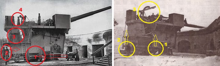

index.php?t=getfile&id=35672&private=0RDX писал(а) сб, 22 ноября 2025 21:03
Приведите фотографии за один период открытых установок 12\52 фортов Алексеевский и Николаевский, с гарантированной идентификацией
In the pictures, the Krasnaya Gorka cannon on the left, red. On the right, the Ino cannon, yellow.
On the left, GK: 1. The projectile is brought to the elevator. 2. The powder charges go into the elevator. 3. The elevator is operated by a hand crank, 4 men, 2 on each side. 4. The projectile and the powder charges are at the top.
On the right, INo: 1. The projectile also comes to the elevator, but there is no elevator car. The projectile is attached to a crane that lifts it up. 2. The powder charges are lifted up by the rear elevator of the carriage. 3 The projectile and the powder charges are at the top. The Finns managed to fire with this cannon in June 1918 before the final demolition of the Fort.
Google Trans
На снимках: слева пушка «Красная Горка», красная. Справа -- пушка «Ино», жёлтая.
Слева, ГК: 1. Снаряд подаётся к элеватору. 2. Пороховые заряды поступают в элеватор. 3. Элеватор приводится в действие ручным приводом четырьмя людьми, по два с каждой стороны. 4. Снаряд и пороховые заряды находятся наверху.
Справа, Ино: 1. Снаряд также подаётся к элеватору, но кабины элеватора нет. Снаряд закреплён на кране, который его поднимает. 2. Пороховые заряды поднимаются задним элеватором лафета. 3. Снаряд и пороховые заряды находятся наверху.

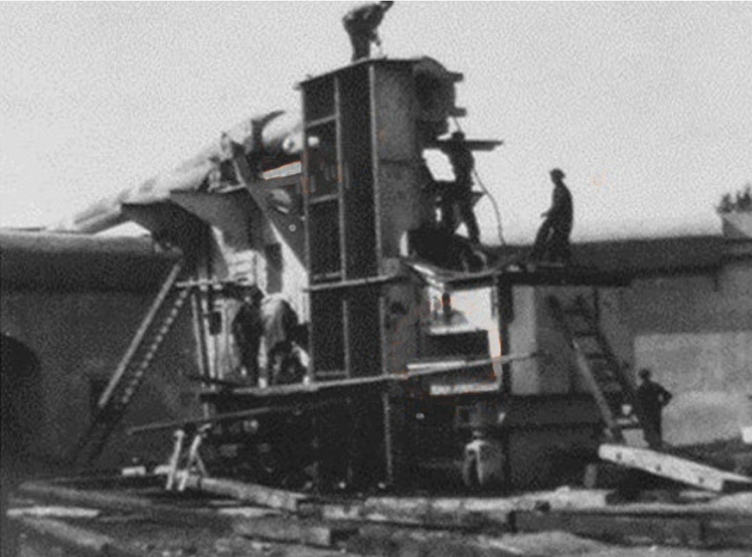

index.php?t=getfile&id=35675&private=0
Thanks Stas, your book is on my shelf! I believe you, but I'm surprised that no one has commented on those strange Ino gun cranes, which are inherited from the oldest prototype of the gun carriage from the Metal Plant, which is still at the Polygon in St. Petersburg.
Another thing that worries me. Why were the guns used manually, even though they were equipped, at least in theory, for electric use. Handling the gun probably required about 50 men! In addition, the guns had a air compressor, but still the guns has compressed air bottles on the back deck, apparently for the automatic loader? Why was there no electricity, even though the Ino's 12" batteries had their own generators?
It's a shame that the more detailed use of the gun is not clear even from Finnish sources, even though RT 2 fired with the intact 12" gun in June 1918. Not a single carriage of this model was spared. This working gun from Ino was also dismantled (picture), the tube evacuated, but the carriage went to Swedish scrap.
  • Вложение: purku.jpg
    (Размер: 144.50KB, Загружено 236 раз)
